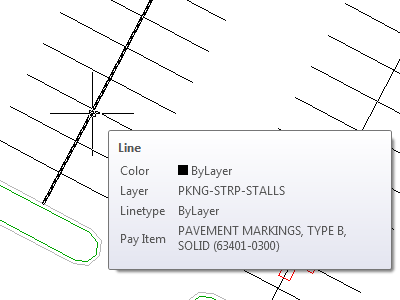

  7. Repeat Steps 2 through 4 to select the lines on the PKNG-STRP-STALLS layer.
    In the drawing, all parking lot stall lines are selected.
  8. Click Analyze tab QTO panel QTO Manager.
  9. In the QTO Manager vista, click .
    Tip:
    You can also right-click the pay item and click Assign Pay Item.
  10. In the Favorites category, select Pay Item ID63401-0300.
  11. Press Enter.
  12. Hover the cursor over one of the parking lot lines.
    The tooltip displays the pay item description and ID that has been assigned to that object.

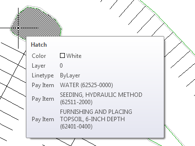

Assign multiple pay item codes to a closed area
  1. In the QTO Manager vista, click .
  2. In the Favorites category, select the following pay items:
    • 62401-0400
    • 62511-2000
    • 62525-0000
    Tip:
    To select multiple items, hold the Ctrl key down and then click the items.
  3. Press Enter.
  4. On the command line, enter O.
    This action activates object selection mode, in which you select the outline of a closed object, as opposed to a point inside the object. Because some of the parking lot islands are subdivided by pipes, you can use object selection mode to assign the pay item codes to the entire object, not only to the closed area that you select.
    Tip:
    For faster performance, zoom in to a closed polygon before you select it.
  5. In the drawing, click the green border in a parking lot island.
    A solid hatch pattern is displayed in the parking lot island. This indicates that the pay items have been applied to the area.
  6. Select several other islands.
  7. Press Enter to end the command.
  8. Hover the cursor over one of the parking lot islands.
    The tooltip displays the description and ID of each pay item that has been assigned to that area.
