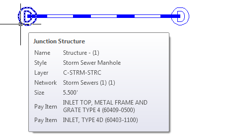

  5. Hover the cursor over one of the new structures.
    The tooltip displays the description and ID of each pay item that has been assigned to that structure.

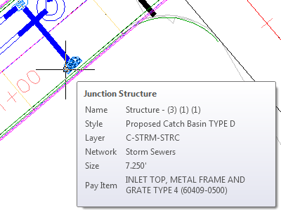

  6. Hover the cursor over one of the catch basins.
    The tooltip displays the description and ID of the pay items that have been assigned to the catch basin.
