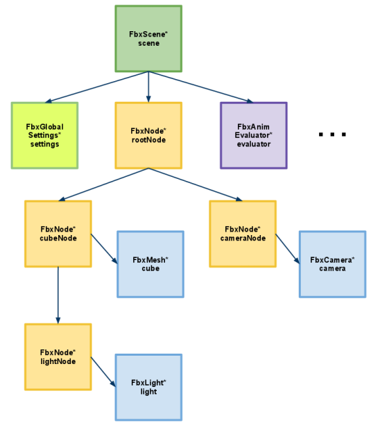

The FBX SDK scene graph is abstracted by the FbxScene class. The scene is organized as a hierarchy of nodes (FbxNode). The root node of the scene is accessed via FbxScene::GetRootNode(). A scene element, for example, a mesh, a light, or a camera is defined by combining a FbxNode with a subclass of FbxNodeAttribute. For more information, see FBX Nodes and FBX Node Attributes.
As illustrated in Managing Memory with the FBX SDK Manager, a FbxScene is created by invoking the FbxScene::Create() function. A new FbxScene contains a root FbxNode, and a FbxGlobalSettings object with a default configuration.

Scene elements are created using a reference to the FbxScene in which they belong. In doing so, the scene will be exported with all the elements which were created with it. In the following sample, a node is created with a reference to the FbxScene, and attached to the root node of the scene.
The scene's axis system, system units, ambient lighting, and time settings are defined in its FbxGlobalSettings object. This object is accessed via FbxScene::GetGlobalSettings().
The scene's FbxAnimEvaluator evaluates the animated geometric transformations of each node in the scene at a specific time. It also evaluates any other animatable property of the scene, for example, the color change of a specific material. The scene's FbxAnimEvaluator is accessed via FbxScene::GetEvaluator(). For more information, see Animation.
The materials (FbxSurfaceMaterial) and textures (FbxTexture) created within the scene can be accessed and modified using member functions such as FbxScene::GetMaterial() and FbxScene::GetTexture(). For more information on using materials and textures with meshes, see Meshes, Materials and Textures.
Characters (FbxCharacter), and character poses (FbxCharacterPose) within the scene can be accessed using FbxScene::GetCharacter() and FbxScene::GetCharacterPose(). Consult the class documentation of FbxCharacter and FbxCharacterPose for more information on how to define characters in a scene.
