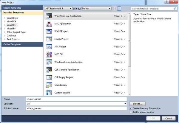

- Start Visual Studio.
- To create a new project, choose the menu.
- Choose .
- Continue as usual, then click . The new project and solution appears.

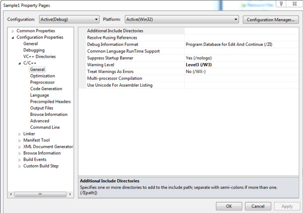

- Right-click on the project, and select . The Property Pages dialog appears.
- In the property tree on the left of the Property Pages dialog, choose .
- In the properties sheet on the right of the dialog, select in the drop-down box. The Additional Include Directories dialog appears.

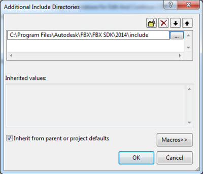

- In the list box on the top of the Additional Include Directories dialog, click the
top blank line until you see a control to browse for directories.
- Use this control to add the full path for the <yourFBXSDKpath>\include directory and click .

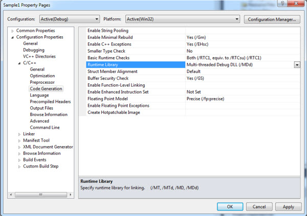

- In the tree on the left of the Property Pages dialog, select .
- In the property sheet on the right, choose the type of run-time library for your project
in the box. The list corresponds to the Visual C++ compiler options: /MD, /MDd,/MT, /MTd, and so on. Not all compiler options are available for all versions of Visual Studio
(see runtime libraries for Windows).

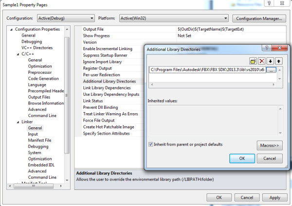

- In the Property Pages dialog box, choose .
- In the drop-down box, select . The Additional Library Directories dialog appears.
- Enter the full path for the <yourFBXSDKpath>\lib folder of the FBX SDK distribution.
