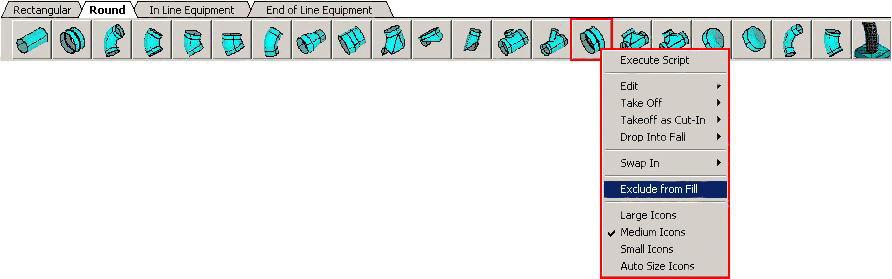

Excluding Individual Items from Fill:
Use the mouse button to Right Click the Item, select Exclude from Fill.

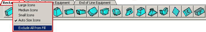

Excluding All Items from Fill:
Use the mouse button to Right Click the Service TAB, select Exclude All from Fill.
