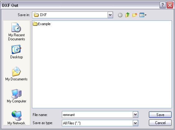

- Click > Profiler - DXF Export and the DXF Out dialogue box will appear.
- Save the part to a relevant location and click OK.

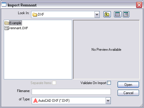

- Right click anywhere in the main screen and from the menu that appears, select Importand the Import Remnant dialogue box will appear.

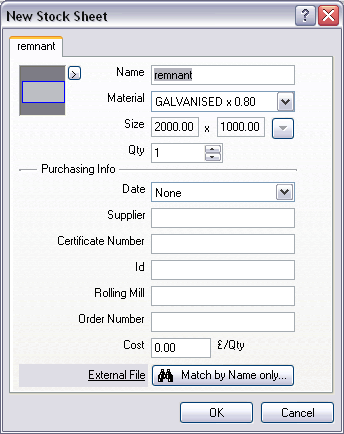

- Browse to the location in which the drawn remnant was saved and select it, click Open and the New Stock Sheet dialogue box will appear.
- This now offers the user to change the name, material and gauge and the quantity of the new remnant. Set as applicable.
- In addition, purchasing information options are available if required.
- Click OK and the remnant is ready to use.
