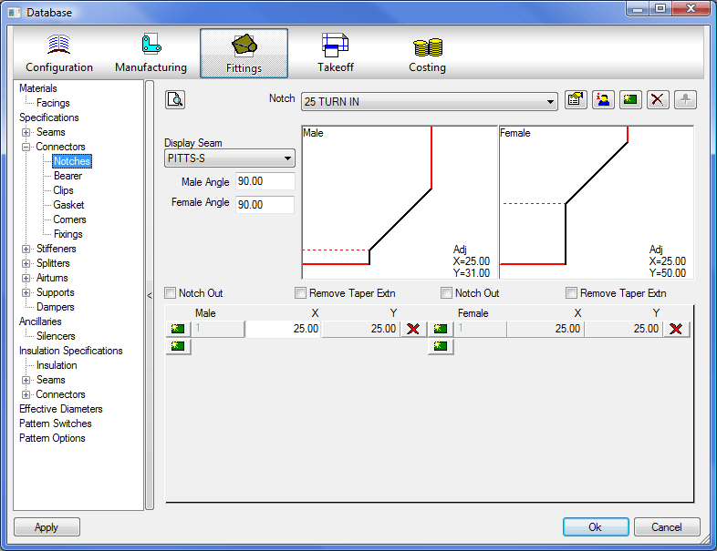

Notches cannot be applied to a development directly. To apply a notch you must first associate it with a connector. Notches are configured from the notches dialogue in the pattern database.

Display Seam
Allows the user to change the seam that is displayed in the notch preview windows. This does not have a direct effect on the notch, but is useful for visualising the notch when in the creation process. The list of seams is taken from the seam database.
Male Angle
Sets the angle to which the male seam will be cut.
Female Angle .
Sets the angle to which the female seam will be cut
Notch (Pulldown Menu)
Displays a list of the currently configured notches. It is inadvisable to change any of the pre-defined notches if you are not sure where they are used. It is safer to create a new notch as there are no limits to the number of new notches creatable. To create a new notch:

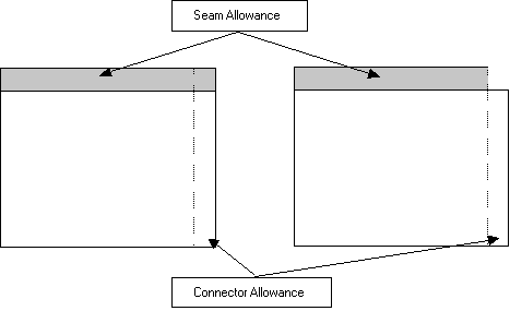

Notch Out
This removes the material where the seam and connector allowances meet.

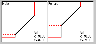

Notch Definition The boxes below the Notch Out and Remove Taper Extension checkboxes can then be used to enter the dimensions of the notch. To create a typical notch follow the example below.
icon to the right of the Notch pulldown menu.
icon on the left hand side of the male column. Note that in the above graphic the Y= lengths are both longer than the values you have entered in, in this case 40 for each. This is because it is adding the Y= allowance to the seam allowance, as defined under the seams tab.

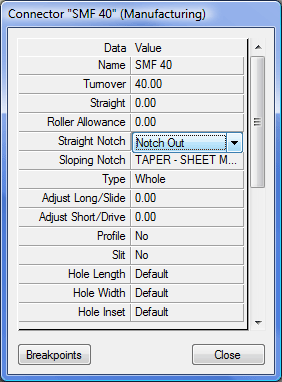

This can then be applied to a Connector using the Straight and Taper Notch fields.
