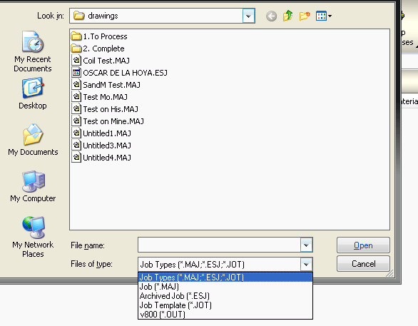

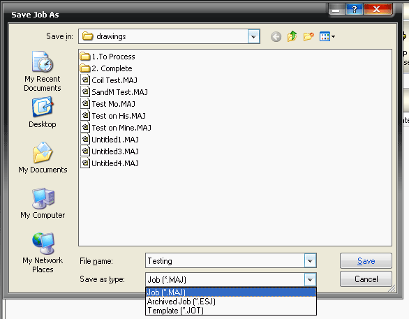

.MAJ (Job File) This is the default format for saving jobs. Jobs can be saved by selecting File
Save Job As. See also .ESJ, below.
.ESJ (Archived Job File) Similar to .MAJ, this is also a format for saving jobs but includes much more information about the job, as it includes your database, and therefore will also save all the settings that can be found in File
Setup
Main Database . This is often required if you need to send your job file to Autodesk technical support, or transfer the job from one location to another, as the settings at different sites may be different to your own (such as specific materials, machine specifications etc.).
.JOT (Archived Job Template) Similar to .ESJ, this is also a format for saving jobs including a copy of your database, but when the job is opened up again, it is treated as a new job and given a new name, whilst still retaining the database parameters of the original job.
Save Job As.
If you have been asked to send the file to Autodesk support, you can then attach it to an email or put it on a floppy. The standard location of the file will be C:/Cam/Projects and (in the above example) the file will be called Untitled2.JOT (or Unititled2.ESJ if it had been saved as an archived job).
