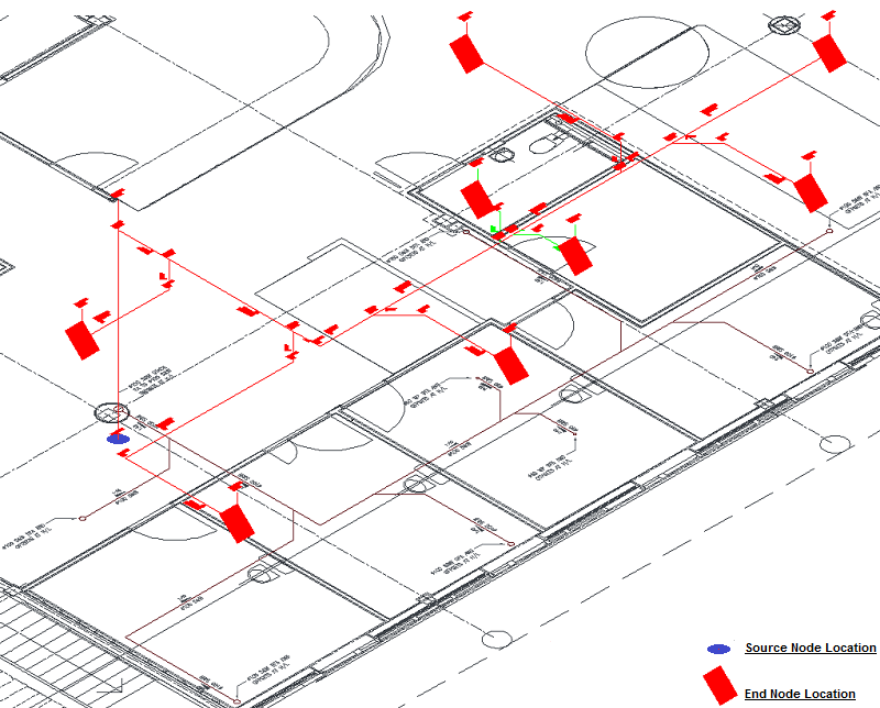

Enables a user to manually select a number of "End node's" within the design line system, this will automatically determine the longest index run from the pre determined Source Node location. Once determined a singular fitting will maintain the required invert level set on the Elevation in relationship to the U/S of Slab level.
Enables a user to automatically select all "End node's" present within the design line system, this will automatically determine the longest index run from the pre determined Source Node location . Once determined a singular fitting will maintain the required invert level set on the Elevation in relationship to the U/S of Slab level.
Public Health Design Line system, illustrating a selection of all "End nodes" of a fitting

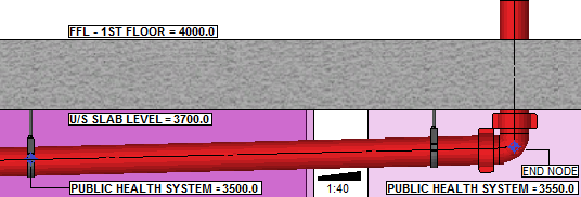

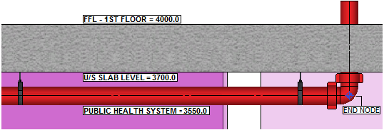

Fix Selection
Functionality to enable a user to manually select end nodes situated at the base of a riser within the public health system. Once determined the fitting will maintain the required invert level based on the Elevation in relationship to the U/S of Slab level.
Functionality to enable a user to select all of the "open ends & nodes situated at the base of the riser within the public health system. Once determined the fittings will maintain the required invert level based on the Elevation in relationship to the U/S of Slab level.
