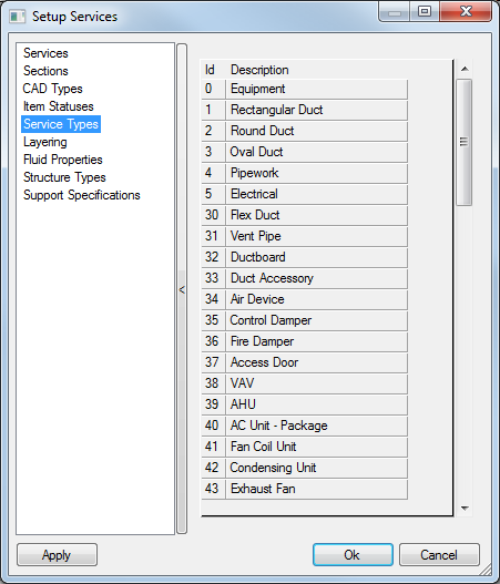

  1. Click the Edit Services Database icon
  2. Select Service Types from the list.
  3. Click the Add New Service button
  4. Type the name of the new service in the Description window.
  5. Click Apply 6.
  6. Click Ok .
    • Id number - N/A
    • Description - This is the name given to the New Service Type added.
To complete the process
  1. Highlight the required item(s) from within the folders.
  2. Right Click and select Service Information 4.
  3. Select the New Service Type.
  4. Click Ok .

Note: Fixed Service Types cannot be removed.
  1. Click the Delete icon that corresponds with the Service Type to be removed.
