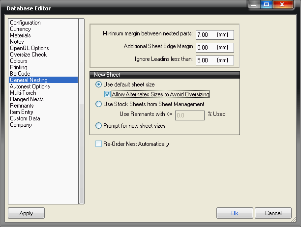

The Allow Alternate Sizes to Avoid Oversizing feature will automatically select the most appropriate sheet size available, within the current material/gauge in order to avoid oversizing parts whilst auto-nesting.
Enabling the Allow Alternate Sizes to Avoid Oversizing option
To activate the Allow Alternate Sizes to Avoid Oversizing option, it must first be enabled in our software's general nesting settings.

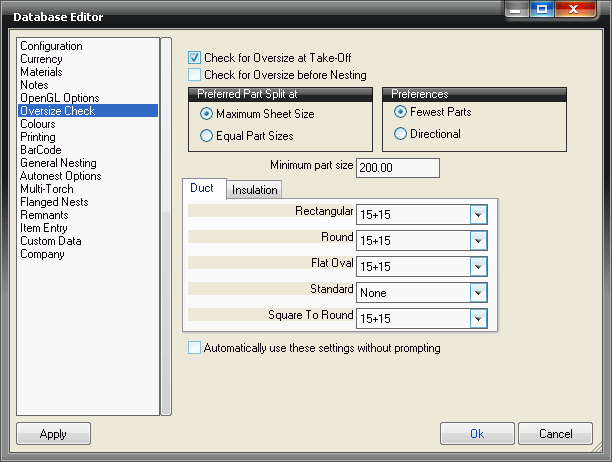

Configuring the oversize options.
It may also be necessary to set up the Oversize Check options as illustrated below.
