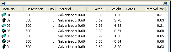

The job contents window displays a detailed list all of the items that exist in the current drawing. For example, it provides a quick method of viewing Items' Connectors or Specifications.
  1. Click the Display Job Contents view button .
    You should now see the Job Contents window as shown below, the list of items and the details.

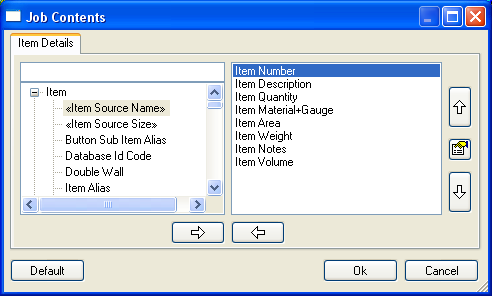

Ensure you are viewing the Detail List as shown above (if you are not viewing the Details List - Right Click blank area below the Header bar, selecting from the Right Click menu: View > Details.
The Header bar is customisable allowing additional details to be shown such as Specification, Connectors etc., to do this:
