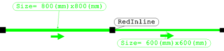

| RedInline |
2 Lines meet and continue in the same direction with different sizes |

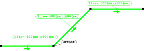

| Offset |
2 Lines meet an angle then continue in the same direction as the first line |

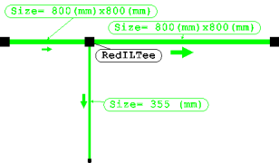

| RedILTee |
3 Lines intercept at an angle in the form of a Tee |

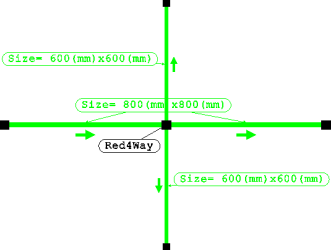

| Red4Way |
4 Lines meet at the same geometric point |
