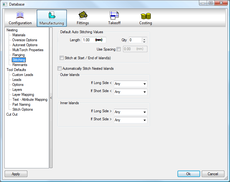

Stitch Options
This option allows uses to automatically stitch nested parts to the criteria set.
Default Auto Stitching Values
This option lets the user define the size of the stitch and the quantity of stitches to place on the Island when Auto Stitching is switched on. Stitches can also be spaces around the Island using the " Use Spacing " check box. There is also an option to apply the stitch to the Start/End point of the Island.
Automatically Stitch Nested Islands
If this option is enabled the user is allowed to configured the following settings. If it is left un-ticked the following options will be unavailable.
Outer Islands - If Long Side <
This option allows the user to enter a value. If the long side of the part is less than the value entered, the part will be stitched. Alternatively select Any and the part will be stitched irrespective of size.
Outer Islands - If Short Side <
This works in the same way as the option above, but is applied to the short side of the part.
Inner Islands - If Long Side <
This is the same as the same as Outer Islands - If Long Side < option, apart from the fact that is applied to the inner islands.
Inner Islands - If Short Side <
This works in the same way as the option above, but is applied to the short side of the inner island.
