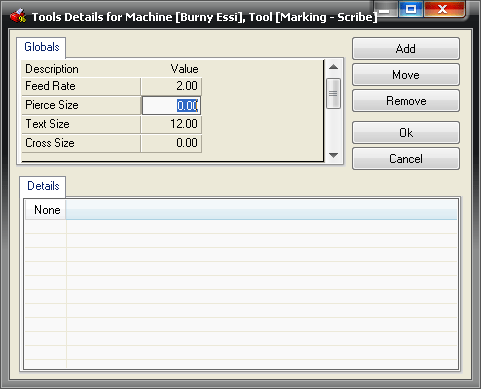

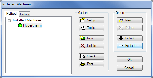

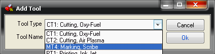

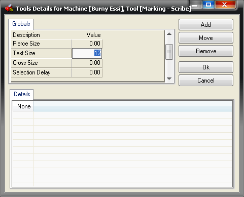

If there is not already a marking tool add one by using the following procedure.

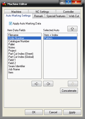

There should now be an extra option tab for Auto Marking Settings in the Machine Editor dialogue.
Auto-marking
Tick the Apply Auto Marking Data box. The data field on the right is the selected text. Select from the left box and use the arrow keys below to move it across. The Concatenate option adds a "+" to the selected item and will allow the marking to be done in a line.
