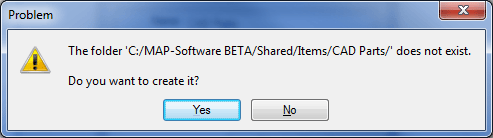

If linking to an existing Folder then either type the path to its location on the hard drive or network, alternatively you can use the Browse button to browse to the directory location. If creating a new folder then you can ignore this field.
When the specified directory does not exist a message box will be displayed asking if you want to create it.
Clicking on Yes will create the folder in the location selected.
The new empty folder will now be displayed in the menu tree and is ready for use.

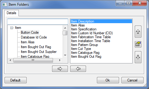

Details:
This icons displays the items in a details view which can be customised by the user using View > Customize from the File Menu.

The contents can be arranged by whatever fields you have selected when using Details. These can be added to or excluded from this list by using the Customize dialogue.
