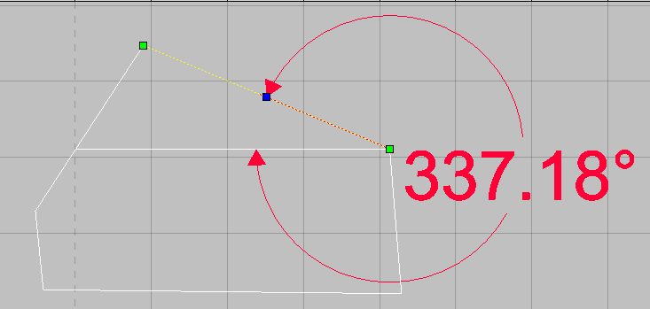

Distance: This is the aligned length of the element.
Angle: This is the angle taken from the Horizontal, this is read in an anti-clockwise direction.

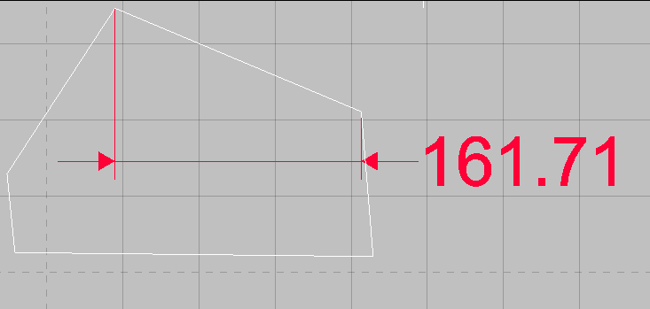

Along X: This is the Linear Dimension read along the X axis.

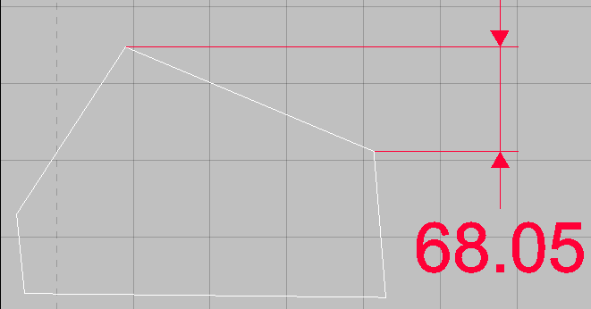

Along Y: This is the Linear Dimension read along the Y axis.
