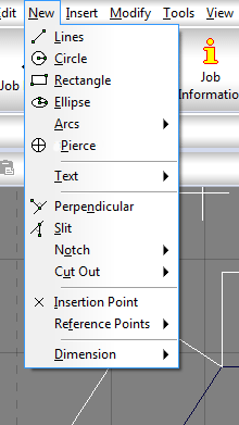

Edit, incorporates:
- Cut - Cut with Base Point - Copy - Copy with Base Point - Paste - Deselect All - Invert Selection
New, incorporates:
- Lines - Circles - Rectangle - Elipse - Arcs - Pierce Point - Perpendicular - Notches - Cutouts - Reference Points - Dimension
Insert, incorporates:
Insert
Modify, incorporates:
- Move - Rotate - Align - Grow - Mirror - Offset - Arrays - Fillet - Chamfer - Reference Points - Modify Text
Tools, incorporates:
- Distance - Length - Opus Repair - Reset Styles
View, incorporates:
Dimension Styles - Item Properties... - Summary - Print - Rulers - Original - Dimension
