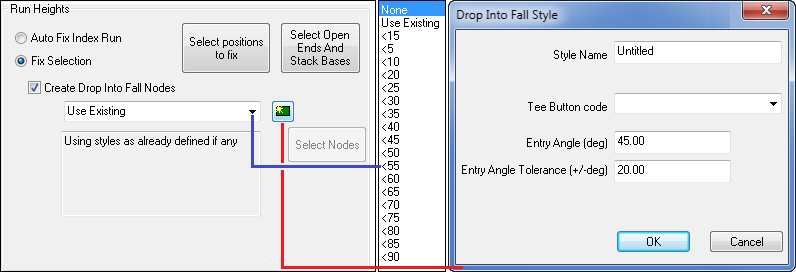

(D) Create Drop Into Fall Nodes
Determines the required drop into fall applied to the Public health system run. This can be applied globally, or alternatively individual Drop into fall nodes can be selected and amended individually.
Note: Additional Fall node settings, can be configured with the
"Add New Style" command.
Main Database Settings
Note: Within the "Create Drop Into Fall Nodes", If "Use Existing" is active. The Drainage Tool will automatically default to the Main database for "Drop Into Fall" Default settings.

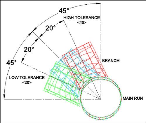

Preferred Branch Entry Angle Configuration
The Preferred Branch Entry Angle currently selected is stated in brackets, in this case <45> (45 Degrees). The Low tolerance & High Tolerance options may be selected and adjusted as necessary by typing LT or HT at the command line when prompted. In the example illustrated below the Low & high Tolerance values are set at <20> (20 degrees), MAP Software will try to provide a solution for the entered angle and will also try angles between entered angle-LT and entered Angle +HT.
