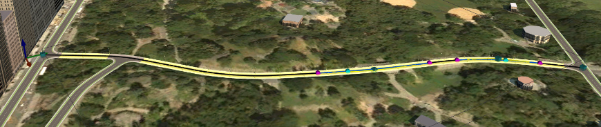

Design roads in Roadway Design for InfraWorks 360 enable precise control over geometry, grades, and cross-slopes. Design roads are 3D and in context of the real world. When working with design roads, you edit the horizontal and vertical geometry separately.
