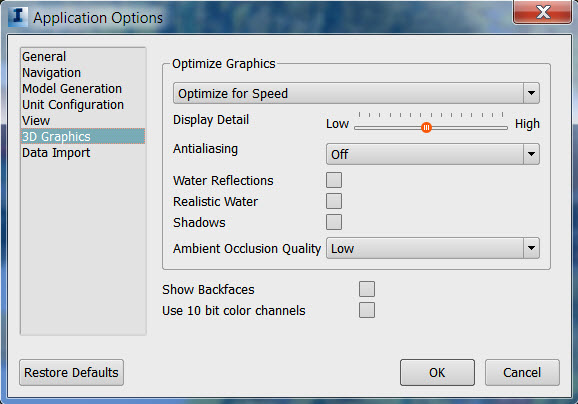

To set 3D graphics options
Choose 3D Graphics settings such as display detail, antialiasing, ambient occlusion quality, shadows, water reflections, realistic water, and backface display options.
  1. Click
  2. Click 3D Graphics to display controls for optimizing graphics and other features:
    • Display Detail specifies Level of Detail (LOD) for terrain, generated assets, and 3D objects. See also Set level_of detail by feature type.
    • Antialiasing
    • Realistic styles are very effective, but they will slow down performance.
    • Turn shadowing on or off.
    • Ambient Occlusion
    • On high performance monitors, 10-bit channels can resolve gradations that are not smooth. However, if you enable this option, you cannot create screenshots or storyboards.
    • Backface display
