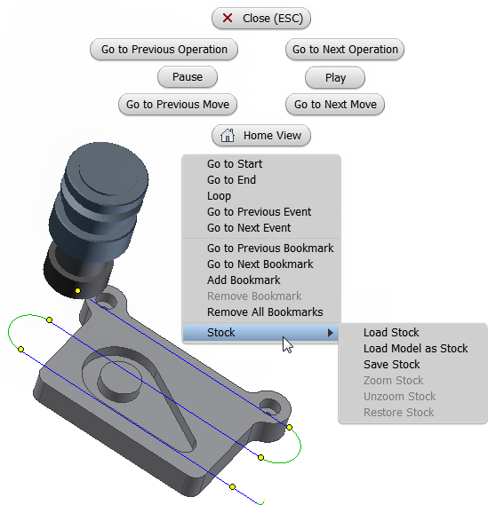

About Toolpath Position Bookmarks
You can also add, view, and remove bookmarks to a toolpath position using other overflow menu options in the Simulation player marking menu. The options include:
- Go to Previous Bookmark - moves to the previous bookmark in the toolpath.
- Go to Next Bookmark - moves to the next bookmark in the toolpath.
- Add Bookmark - adds a bookmark at the current toolpath position. Keep in mind that any added bookmarks are automatically cleared when you regenerate an operation.
- Remove Bookmark - removes the current bookmark.
- Remove All Bookmarks - removes all the bookmarks.
The bookmark options in the Simulation player marking menu. The six yellow circles on the toolpath indicate existing bookmarks.
Remember: Adding bookmarks to a toolpath can be very helpful before submitting feedback to the Inventor HSM Pro team. We would very much appreciate that you do this if you have a question regarding a specific part of a toolpath.
