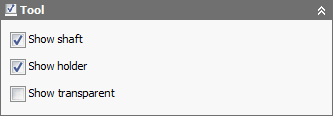

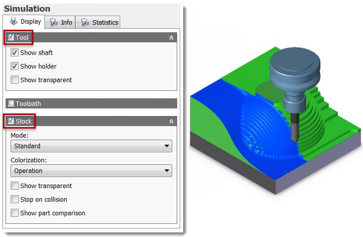

The Tool Group
The Tool group lets you toggle the on/off visibility of the tool shaft and tool holder during the simulation. You can also choose to have them shown transparently which enables you to see right through them.

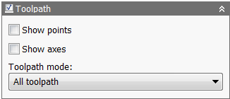

The Toolpath Group
The Toolpath group contains various options for controlling the toolpath visualization. The available options allow the entire toolpath, all toolpath before or after the current tool position, toolpath for the operation, or toolpath tail until the current tool position to be shown during animation.

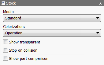

The Stock Group
The Stock group allows you to specify if the stock is shown or not by enabling the Stock check box at the top left of the group. It also contains various options for controlling the stock colorization, quality, material, and stock transparency. You can also choose between Standard and Fast (3-axis only) stock simulation modes. For more information about stock simulation modes, colorization, stopping on collision, and showing a comparison between part and stock, see the Inventor HSM Pro Help topic: About Showing Stock Simulation.

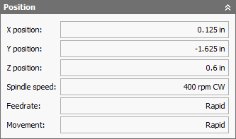

The Position Group
The Position group contains information about the current tool position. The information includes the current position, spindle speed, feedrate, and movement. In non-animation mode the information applies to the currently highlighted position if active and otherwise the current tool position, whereas in animation mode the current tool position is always shown.

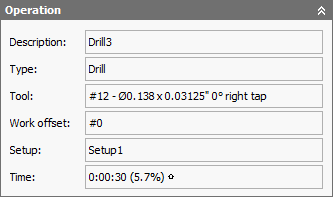

The Operation Group
The operation-specific information for the strategy containing the current tool position or highlighted position is shown in the Operation group. The numbered operation description given in the Operation dialog box for the strategy and the active tool are displayed.

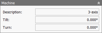

The Machine Group
This group shows information about the machine for which the simulation is generated. It is particularly helpful when using a multi-axis strategy.

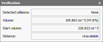

The Verification Group
The Verification group displays the number of collisions between the shaft and/or holder and workpiece, if any. It also reports the Start volume: which is the total volume of the original stock. The stock removed in the simulation is reported by the Volume: value.
Additionally, points on the stock can be measured by moving the mouse cursor over the point of interest. The Distance: value displays the signed (positive or negative) minimum distance between the stock and the model surface. A negative value indicates a gouge.

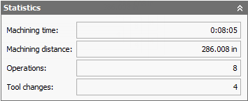

Statistics tab settings
The Statistics group contains information about the entire toolpath being simulated. The current information is the total machining time, the total machining distance, the number of operations performed, and the number of tool changes. Please note that the machining time is a rough estimate which can be far from the actual machining time after post processing.

In addition to the ordinary simulation, you can enable the Stock check box to show stock inside the normal simulation. It is also possible to show the tool, toolpath, and stock individually or together, by enabling or disabling the respective Tool, Toolpath, and Stock check boxes.
Simulation with tool and stock shown
