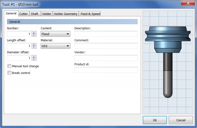

General tab settings
Number:
The number used to select the tool on the CNC machine.
Length offset:
The index of the tool length offset. This parameter is normally set when using tools with multiple tips indexed by length.
Diameter offset:
The index of the tool diameter offset.
Manual tool change
Enable to force a manual tool change on machines with an automatic tool changer.
Break control
Enable to check for tool breakage after use.
Coolant:
The type of coolant used with the tool.
Material:
The tool material.
Description:
A textual description of the tool. This description is included in the tool name shown throughout Inventor HSM Pro.
Comment:
A text comment for the tool. The comment is typically included in the post-processed output.
Vendor:
The vendor of the tool. Use this to identify the specific tool used.
Product id:
The vendor's identifier (ID) for the tool. Use this to identify the specific tool used.

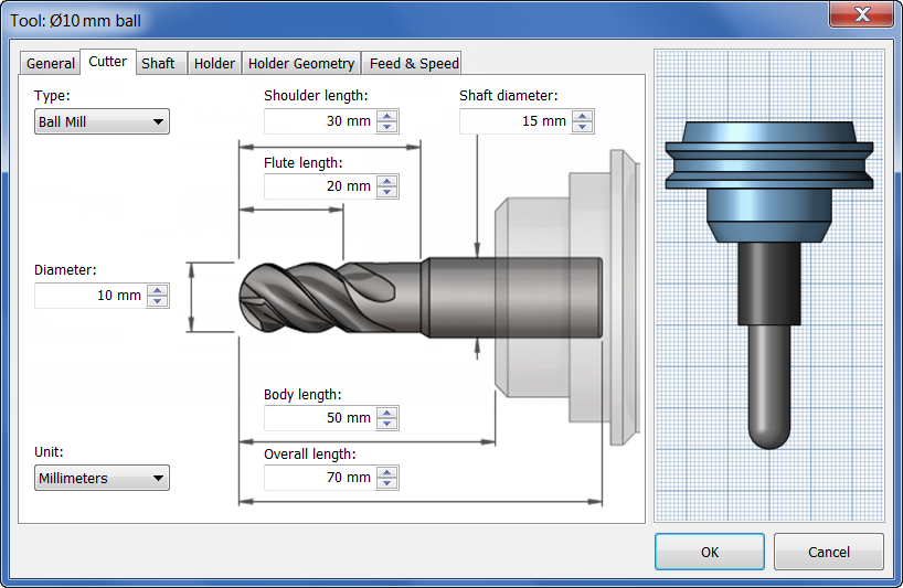

Cutter tab settings
Type:
The type of the tool.
Diameter:
The diameter of the cutter.
Unit:
The tool unit (Millimeters or Inches).
Tip diameter:
The tip diameter of the cutter.
Corner radius:
The corner radius of the cutter.
Taper angle:
The taper angle.
Tip angle:
The angle of the tool tip. This angle is used to calculate the extra depth needed to break the tool through the material.
Flute length:
The tool flute length.
Shoulder length:
The tool shoulder length.
Body length:
The tool body length.
Overall length:
Specifies the entire length of the tool.
Shaft diameter:
The tool shaft/arbor diameter.
Thread pitch:
The pitch of the tap thread, specified as the vertical distance between the teeth of the tap.

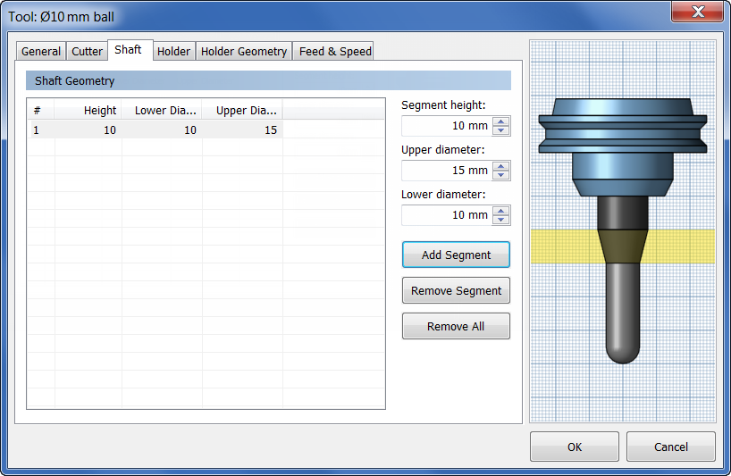

Shaft tab settings
Segment height:
The height of the selected tool shaft segment.
Upper diameter:
The upper diameter of the selected tool shaft segment.
Lower diameter:
The lower diameter of the selected tool shaft segment.

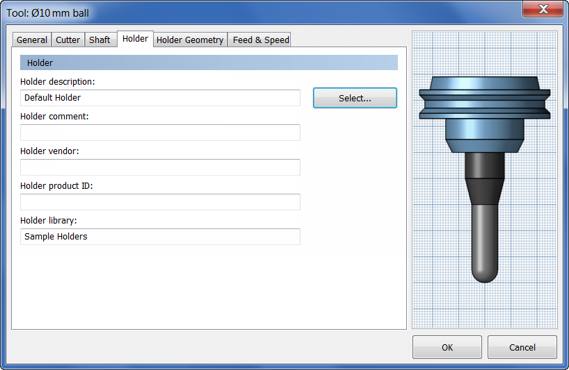

Holder tab settings
Holder description:
A textual description of the tool holder.
Holder comment:
A text comment for the tool holder.
Holder vendor:
The vendor of the tool holder.
Holder product ID:
The vendor's identifier (ID) for the tool holder.
Holder library:
The library where the tool holder is stored.

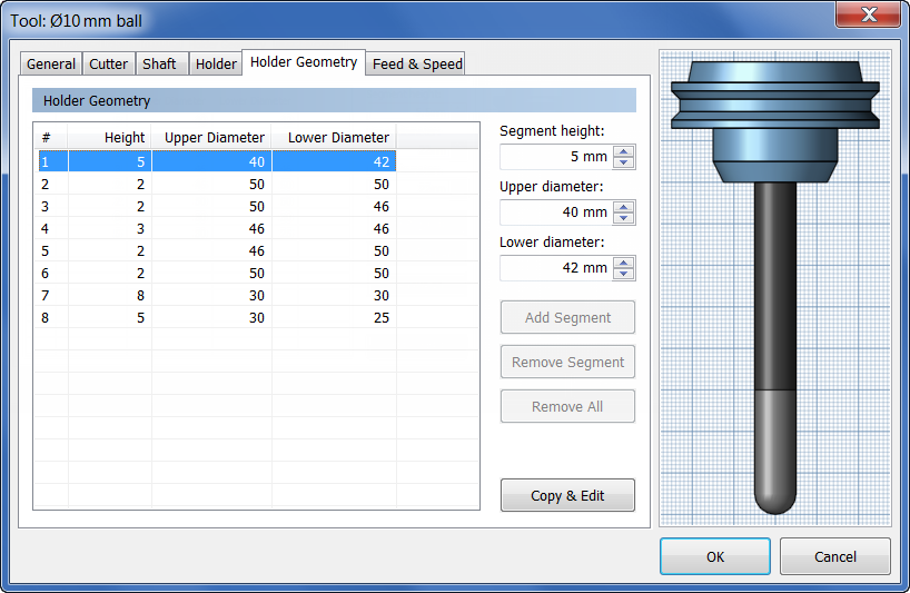

Holder Geometry tab settings
Segment height:
The height of the selected tool holder segment.
Upper diameter:
The upper diameter of the selected tool holder segment.
Lower diameter:
The lower diameter of the selected tool holder segment.

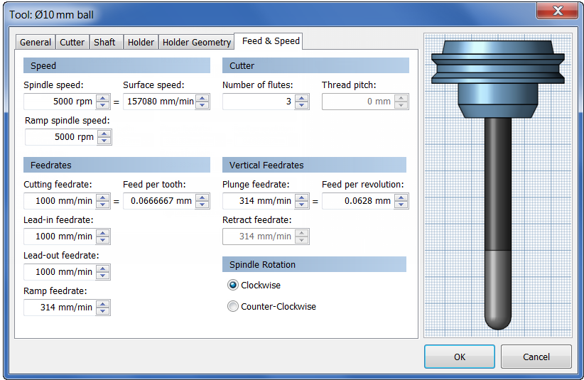

Feed & Speed tab settings
Speed group
Spindle speed:
The rotational speed of the spindle.
Surface speed:
The spindle speed expressed as the speed of the tool on the surface.
Ramp spindle speed:
The rotational speed of the spindle when performing ramp movements.
Cutter group
Number of flutes:
The number of cutting flutes on the tool.
Thread pitch:
Feedrates group
Cutting feedrate:
Feed used in cutting moves.
Feed per tooth:
The cutting feedrate expressed as the feed per tooth.
Lead-in feedrate:
Feed used when leading in to a cutting move.
Lead-out feedrate:
Feed used when leading out from a cutting move.
Ramp feedrate:
Feed used when doing helical ramps into stock.
Vertical Feedrates group
Plunge feedrate:
Feed used when plunging into stock.
Feed per revolution:
The plunge feedrate expressed as the feed per revolution.
Retract feedrate:
Feed used when retracting and not using rapid (G0) moves.
Spindle Rotation group
Clockwise
This option is active by default. All tools (except left-handed taps) rotate clockwise (M3).
Counter-Clockwise
If selected, spindle rotation is reversed.
