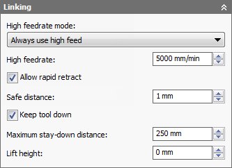

You may occasionally prefer to use high feed movements rather than rapid movements. In these cases, you can set the High Feedrate Mode on the Linking tab.
Changing rapid movements to high feed movements at 5000mm/min
