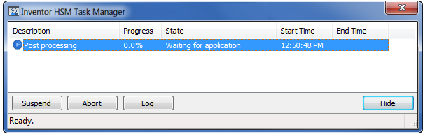

Since the post processor runs in the background, any executed application during posting will not block the main Inventor HSM Pro user interface. The user can see in the Task Manager that the post, is in fact, waiting for an application to complete. In this particular example, that is until the user clicks either "Cancel" or "Accept". You can always abort the post processing immediately from the Inventor HSM Pro Task Manager in case the third-party application should get stuck.
Post processor waiting for application to complete
