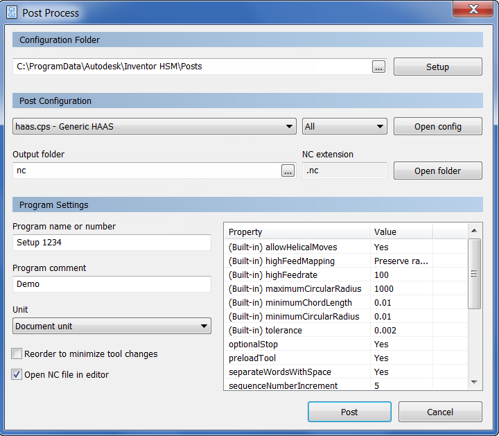

To post process toolpaths, first select the desired operations in the CAM Browser and then, from the ribbon, click CAM tab Toolpath panel Post Process . The Post Process dialog box is displayed to allow configuration of the post processor.
Important: The generated NC code must be verified before use on CNC machines.
By default, Inventor HSM Pro is configured to use the generic post configurations that are installed with Inventor HSM Pro. It is recommended that you create a dedicated folder at an appropriate place for the customized post configurations to ensure that the configurations are not lost when upgrading Inventor HSM Pro at a later time.
When the Post Process dialog box is first opened, it scans the folder containing the post configurations for default properties and makes all working post configurations available to you.
To post process, you must first choose the desired post configuration, enter an appropriate program name and comment, setup the user-defined properties if required, and finally click the Post button. Modified user-defined properties are highlighted in bold and blue. The entered post processing properties are preserved between posting sessions so you only need to set your preferences once. However, if a post configuration is modified some parameters may have to be reentered.
Please note that the post processing time can vary greatly depending on the complexity of the post configuration and the size of the toolpath. Generally, post processing should complete within a few seconds. The post processor runs as a background task making it possible to keep working while the NC code is being generated. The post processor task is listed in the Inventor HSM Pro Task Manager. If the post processing fails (e.g. if the program name is not supported), the error message can be viewed from the task manager by opening the task log.
If the Open NC file in editor check box is activated, the generated NC code is then opened in the preferred editor as defined in the CAM preferences. Alternatively on failure, the post processing log is opened in the selected editor. The NC editor installed with Inventor HSM Pro is used as the editor by default.
