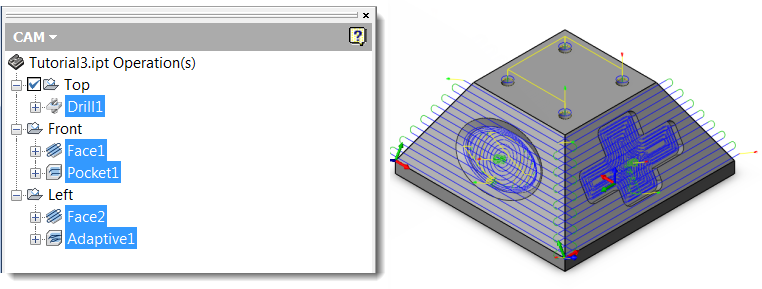

A 3+2 part with a setup for each side to be machined
