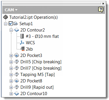

The CAM Browser is the placeholder for all your toolpaths. All toolpaths are organized in setup folders which describe the physical setup (e.g. your work coordinate system). A complete program is composed of one or more individual operations which contain the actual generated toolpath (cutter location information). For more complex setups, it can be useful to organize the operations into subfolders.
The ordering of the setups and operations within the CAM Browser is also the ordering that is generally reflected in the final NC program or when simulating the toolpath. Toolpath patterning and tool reordering are the only features that can influence the listed order.
The CAM Browser

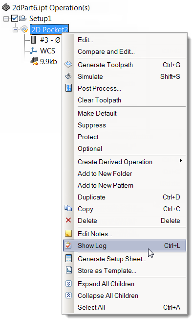

After generating a toolpath in Inventor HSM Pro, the operation may sometimes be marked with an orange checkmark.
The orange checkmark indicates that a toolpath was generated successfully but with one or more warnings
To see what the warning is, right-click the operation and select Show Log from the pop-up context menu.

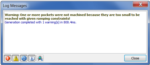

In the image below, the 2D Pocket operation cannot clear all selected areas because there is not enough room for a ramp with the given settings.
This displays the following warning in the Log:

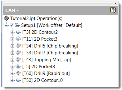

Additional information can be shown in the CAM Browser alongside the name. Please refer to the To Display Extended Information in the CAM Browser Help topic to learn more about CAM Browser options.
Extended information
