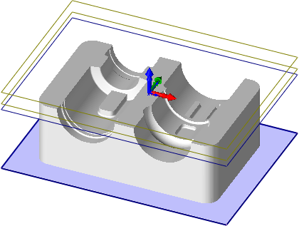

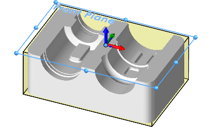

With an STL model loaded, a preview of the STL is shown in the graphics window and the automatic stock feature is enabled
Automatic Stock on an STL
Heights "From Model Top/Bottom" and "From Stock Top/Bottom"

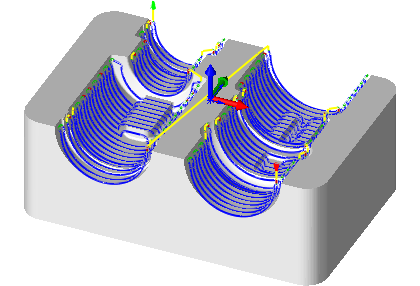

Parallel toolpath on an STL
