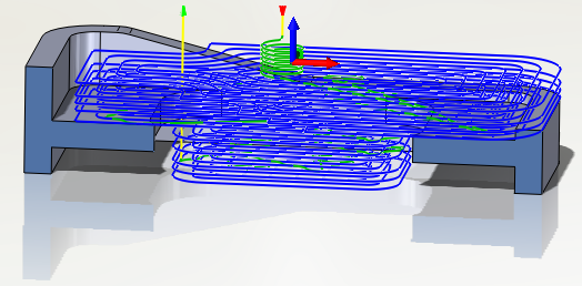

  1. Create two setups with two different tool views, in this example called Job1 and Job2.
  2. Create operation(s) in Job1 that removes stock that is also reachable in Job2.
    Job1 roughing

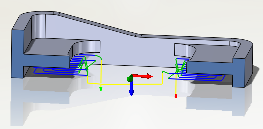

  3. In the setup of Job2, enable Continue machining from previous job.
    Enable Continue machining from previous job in Job2
  4. Create operation(s) in Job2 that have Rest Machining enabled and set to From Previous Operation(s).
    Job2 roughing considers the material removed in Job1
