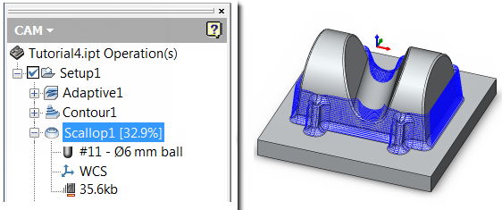

If you select a calculating operation, the preview shows the toolpath generated up to that point. This can be very useful for spotting incorrect parameters early in the process - like an incorrect machining boundary - without having to wait for the calculation to complete.
Preview for a partially generated Scallop toolpath
