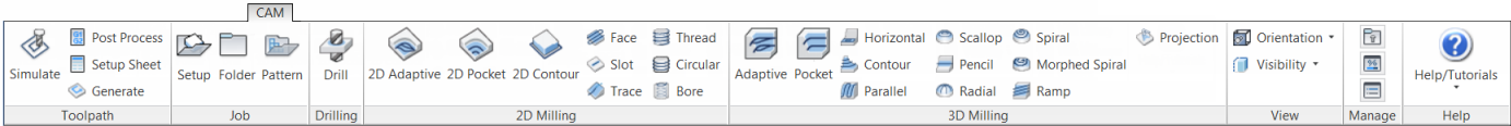

The commands offered on the Inventor HSM ribbon are shown below:

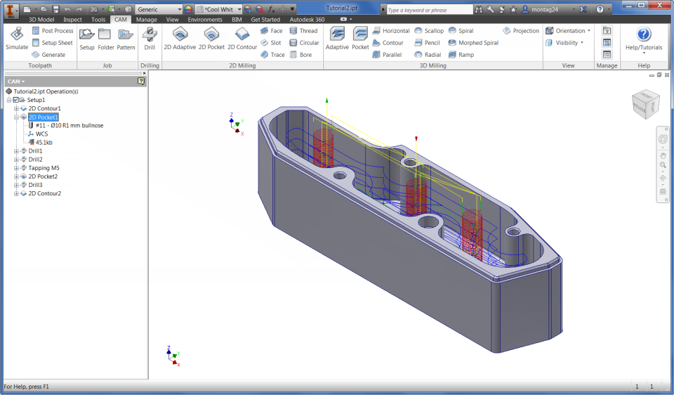

Once a part or assembly file is loaded and a strategy selected from the CAM ribbon, the CAM Browser becomes active replacing the familiar Inventor Model Browser. The CAM Browser lets you view and modify all machining-related data in the current part or assembly.

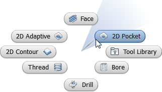

To create your first machining operation, simply select any of the toolpath strategies from the CAM toolbar. The type of toolpath required naturally depends on the geometry of your part. For a description of the individual machining strategies, please refer to the Inventor HSM Help topics: About 2D Machining Strategies and About 3D Machining Strategies.
The following example illustrates a 2D Pocket strategy which is used to remove the interior cavity of a part .

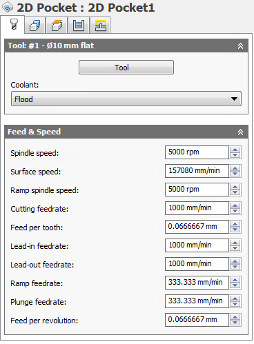

The Operation dialog box then replaces the CAM Browser at the left side of the graphics window, and prominently displays in its title bar the strategy name you selected. Just to the right of the strategy name is the operation number. Since this is the first 2D pocket operation for the part, the name displays as 2D Pocket1. The next 2D pocket operation will display as 2D Pocket2, and so on. This naming convention applies to all setup and machining strategies in Inventor HSM.
The Operation dialog box for the 2D Pocket strategy. Note that the Tool tab is active by default..
Click the Tool button to open the Tool Library. Select an existing tool from a tool library by expanding the tree, selecting a tool, and clicking the OK button. Alternatively, you can create a new tool by clicking the New Mill Tool button, editing the parameters, and then clicking the Select button.

Having successfully generated a toolpath, you can see a preview of the toolpath generated on top of the model simply by selecting the corresponding operation in the CAM Browser.

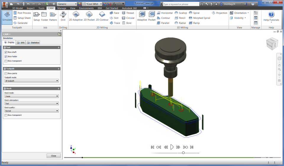

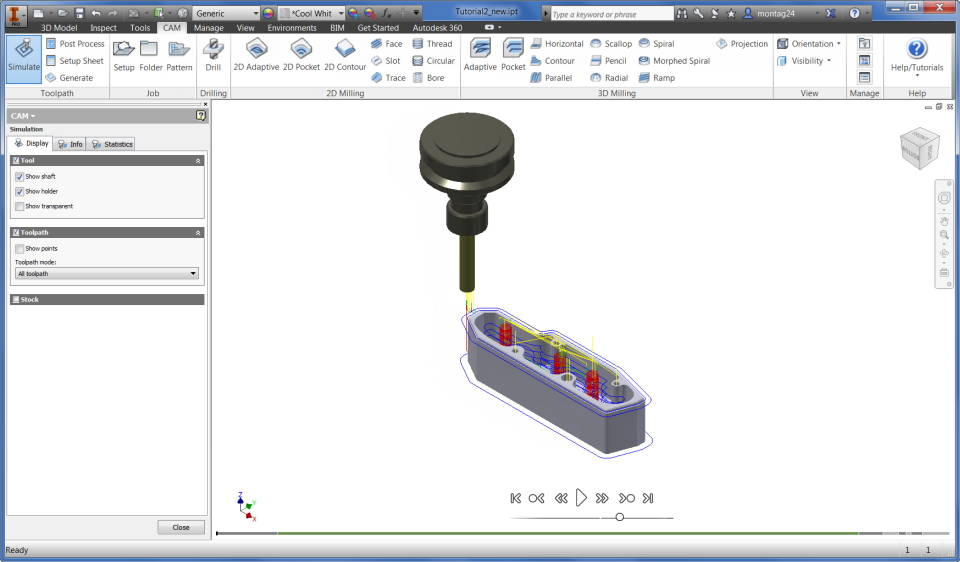

To simulate the toolpath, select one or more operations from the CAM Browser (multiple operations can be selected by pressing and holding the Ctrl key while clicking with the mouse), and then click
CAM tab
Toolpath panel
Simulate
on the CAM ribbon.
To invoke the solid simulation, enable the Stock check box in the Simulation dialog.

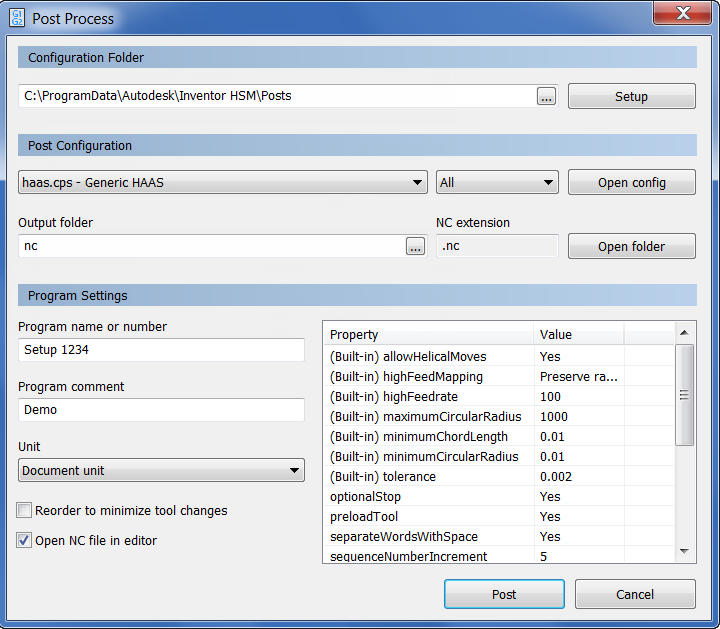

Inventor HSM ships with a number of customizable post processors that can be invoked by selecting one or more operations from the CAM Browser, and clicking
CAM tab
Toolpath panel
Post Process
on the CAM ribbon.
