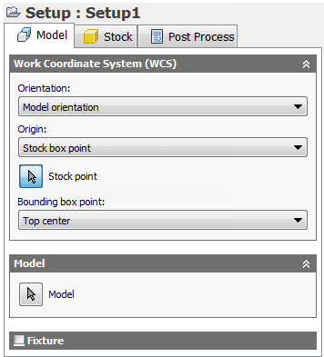

The Setup operations dialog box appears with the Model tab active
Set the Work Coordinate System (WCS) Origin
In the graphics window, the stock material is created automatically around the bounding box of the part. The model orientation is shown by the WCS at the top of the part. The XYZ orientation is correct, but the WCS origin needs to be redefined.
- In the Work Coordinate System (WCS) group, select Stock box point from the Origin: drop-down menu.
- Click the Stock point button and select the point (represented by a back dot) at the lower-left corner at the top of the stock. Alternatively, you can also select Top corner 1 from the Bounding box point: drop-down menu.
The WCS is located at the Top corner 1 bounding box point
