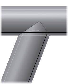

Now that the support tubes extend past the other tubes, we can notch the supports to fit the mating tubes.

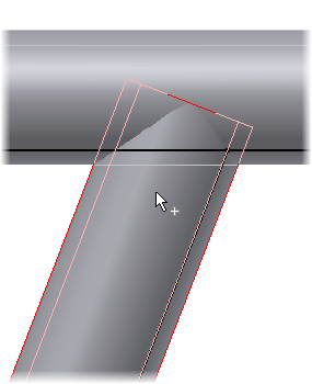

- Select the component to notch, which is the lower tube.

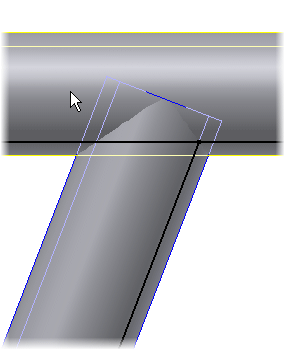

- Click the notching profile, which is the upper tube.
- Click OK. The lower tube is notched to fit the upper tube.
