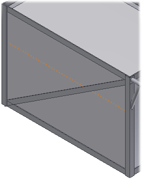

Next, we add angular braces.
- Orient the model view as shown.
- On the ribbon, click Design tab
Frame panel
Insert Frame
- Select DIN 59 370 S Angle Steel from the Family menu.
- Select S 35 x 5 from the Size menu.
- Select the Insert Members Between Points option.
- Select the start point. This point is the corner vertex on the skeletal model.
- Select the end point.
- Set the orientation indicator, as shown.
Enter -5 mm in the Vertical Offset field.
- Enter 0.00 mm in the Horizontal Offset field.
- Enter 0.00 deg in the Angle field.
- Click Apply.
- Use this procedure to add another brace on the other side. Change the value for the angle to 180.00 deg, and click the Mirror Frame Member command.
- Click Cancel when finished.
