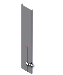

  1. On the ribbon, click Sheet Metal tab Sketch panel Create 2D Sketch , or right-click and select 2D Sketch from the marking menu. Then select the face shown in the following image.
