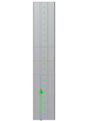

- Select the hole as the feature to pattern.
- Click the Direction 1 button and select a vertical edge and direction as shown:
- Enter a value of 20 for the total number of holes, and a value of 25 mm for the distance between each hole.
- Click OK to create the pattern of holes that cross the two flattened roll faces and close the Rectangular Pattern dialog box.
