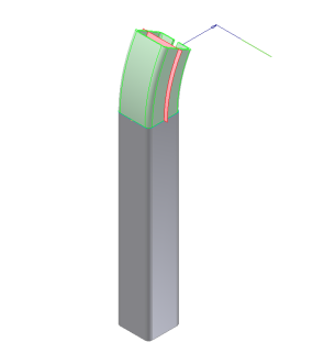

A 90 degree Contour Roll section previews; however, what is previewed is not what you want for this exercise.
- Clear the default Rolled Angle value of 90 deg degrees and enter 30 deg into the value field.
Your preview should now appear as follows:
- Click OK to create the 30-degree Contour Roll segment and close the dialog box.
