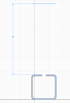

  3. In the graphics window, click to select the lines and arcs that define the outside edge of the Contour Flange feature as shown:
    Note: Be sure to select individual lines and arcs rather than the face loop of the detail faces.
  4. Click Sketch tab Create Panel Line , or right-click and select Line from the marking menu.
  5. Create a line to represent your axis of revolution as shown:
    Note: The length of this line is not important; however, the line should be parallel to the short, horizontal line segments that you projected into your sketch. You can either imply the parallel constraint as you draw the line or add a parallel constraint after the line has been drawn.
  6. Click Sketch tab Constrain panel Dimension , or right-click and select General Dimension from the marking menu. Place a 100-mm dimension between the line you created and the short, horizontal line segment that you projected into your sketch.
