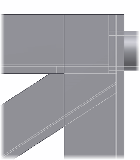

Finally, we trim the supports to meet the vertical frame members.
- Turn off the Visibility of frame_generator_hybrid:1, and then orient the model view as shown.
- On the ribbon, click Design tab
Frame panel
Trim/Extend
- Select the angular braces.
- Click the Face command, and then select the cutting face.
- Click Apply.
- Select the angular braces again.
- Click the Face command.
- Select the cutting face.
- Click Apply.
- If you like, you can repeat this procedure for the other end of the braces.
