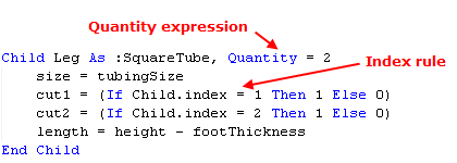

The following example shows a rule that creates a child list with two parts.
In this case, the parameters cut1 and cut2 are different for each child.
