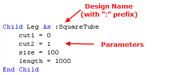

The following example shows the syntax of a child rule.
The design name expression must return the name of a valid design. The simplest expression uses a colon + identifier (such as :SquareTube) to return a name. The design name can also be specified by a more complex expression. This expression is evaluated before the child exists, so it cannot refer to anything inside the child, unlike parameter assignments.
