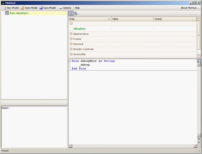

  1. In the Intent /bin directory, open MinHost.exe.
  2. Click the lower right window, and enter the following:
    Rule debugHere As String
     _debug
    End Rule
  3. Click OK. The (dynamic) rule compiles and is added to the root.
  4. Expand the “empty” category at the top to view an image like the following:
  5. In the Value cell to the right of debugHere, click, and select Evaluate. The Intent Debugger displays.
