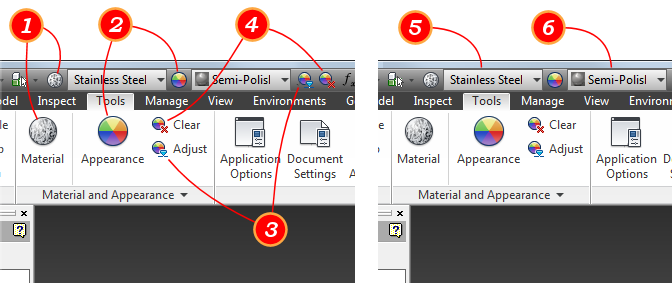

Materials
Materials are a combination of different types of property sets referred to as assets. Inventor materials utilize two assets; physical, and appearance. Together, the two assets make up an Inventor material definition. Materials are assigned to parts.
Physical properties provide information about material composition that is used for simulation, analysis, and to determine iProperties such as mass, area, and volume. Physical properties can be used to determine the appropriate material for your design. |
Appearances
Appearance properties provide visual feedback for a material, such as color, texture, bump mapping, and grain. All materials have appearances assigned to them. You can override those appearances to change the component look. |
