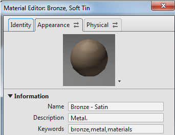

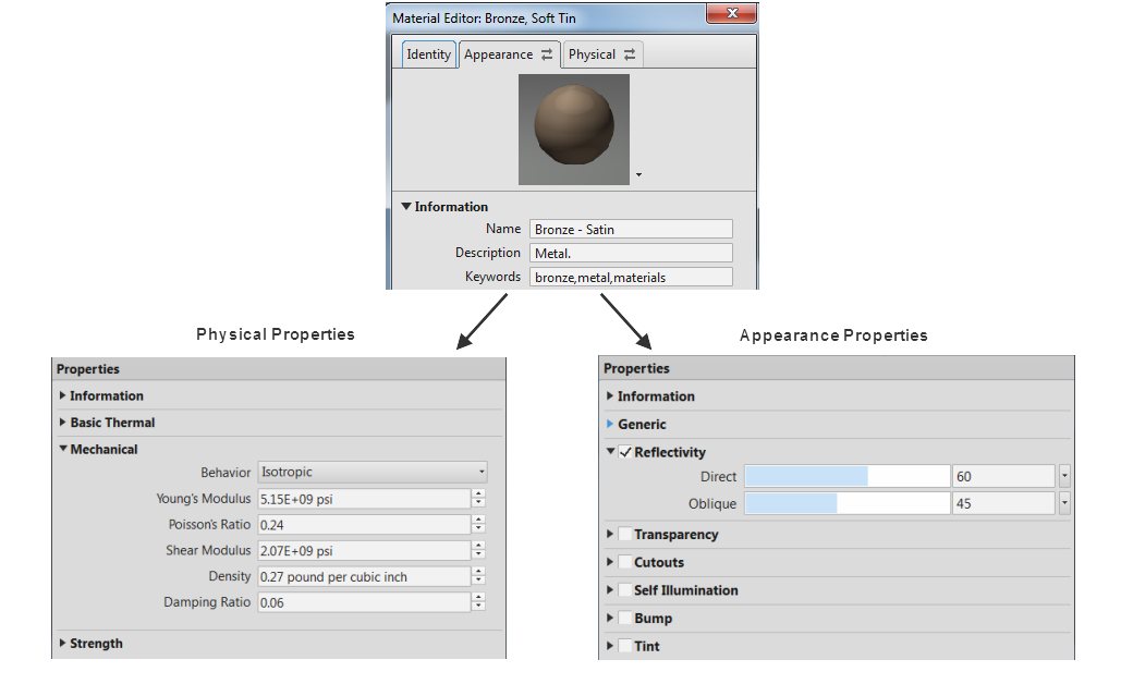

Properties of a Material

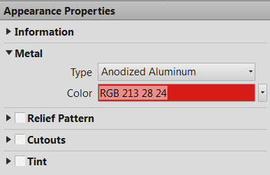

The figure shows some of the physical and appearance properties for a Bronze, Soft Tin material, as displayed in the Material Editor. The physical properties are grouped in one asset of the material, and the appearance properties in another. When you edit a material, you can change each asset independently. For example, you can change the bronze material to have a red color. Replace the appearance asset with Aluminum, Anodized Red, an asset with different appearance properties.
Aluminum, Anodized Red Appearance Asset
You can replace the physical asset for the Bronze, Soft Tin material with a physical asset that represents another metal, such as aluminum or copper. However, the changes in density and other properties result in a material with different behavior.

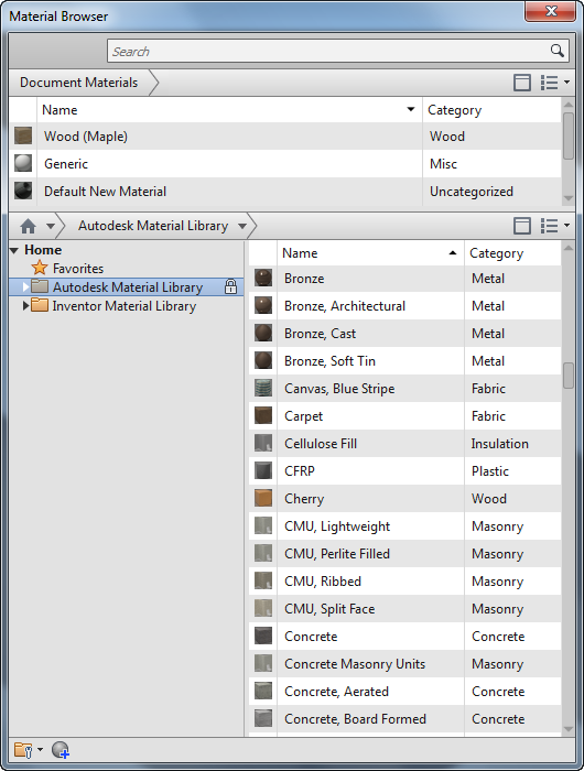

Material Browser
The Material Browser is used to find and manage materials. Common operations include

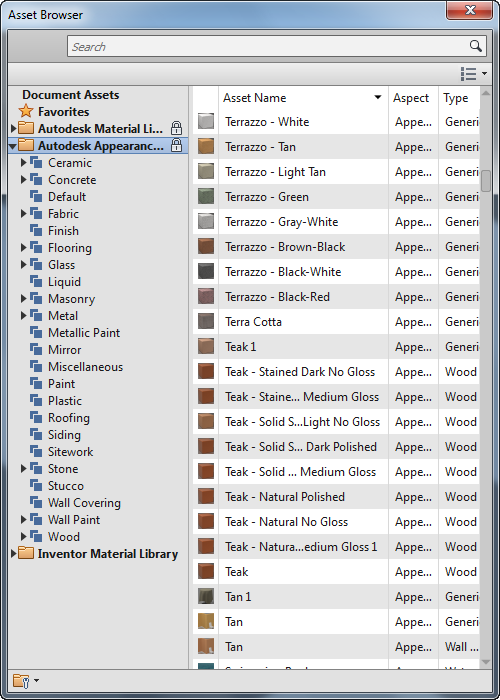

Asset Browser
Tto manage and review available assets, use the Asset Browser. It is useful for finding an asset to add to a material or to replace an existing asset of a material.
