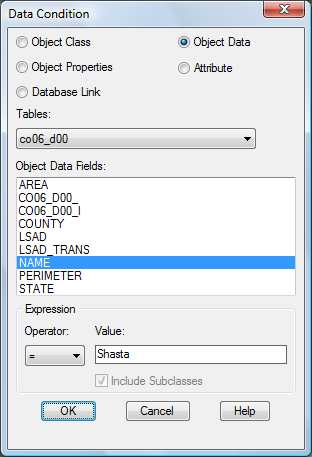

  2. In the Define Query Of Attached Drawings dialog box, under Query Type, click Data.
  3. In the Data Condition dialog box, select the Object Data option.
  4. In the Object Data Fields list, select NAME.
    Note:
    Do not change the Tables setting.
  5. Leave Operator set to = . For Value, enter Shasta.
    Define the data condition for the query.
    The query is case sensitive. Be sure to enter it as shown.
  6. Click OK in the Data Condition dialog box, and then click Execute Query.
