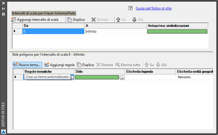

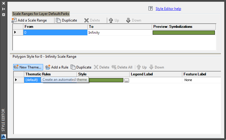

    • In Display Manager , select the Parcels layer and click Style.
      Note:
      If the Style Editor is docked, move your cursor over it to display it. It might be docked at the left side of the application window.
    • In the Style Editor, under Polygon Style For 0 - Infinity Scale Range, click New Theme.
      Click New Theme to define a theme for the Parcels layer.
