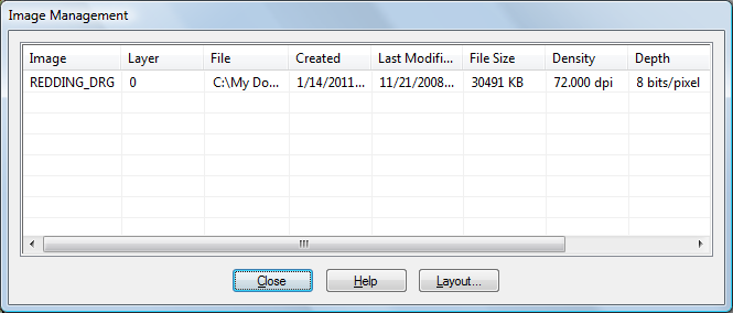

  2. In the drawing area, place your cursor over the image, hold down the Shift key and click the image.
  3. Click Insert tabImage panelImage Management. Find
  4. In the Image Management dialog box, view information about the REDDING_DRG image.
    The Image Management dialog box displays information about the selected image.
  5. Click Close when you are finished.

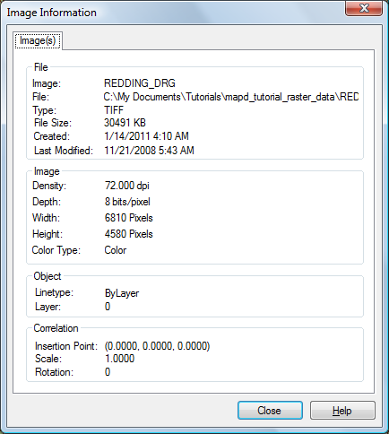

  6. Select the image again.
    Place your cursor over the image, hold down the Shift key, and click the image.
  7. Right-click the selected image and click ImageInformation.
  8. In the Image Information dialog box, view information about the REDDING_DRG image.
    The Image Information dialog box has some extra image information.
  9. Click Close when you are finished.
