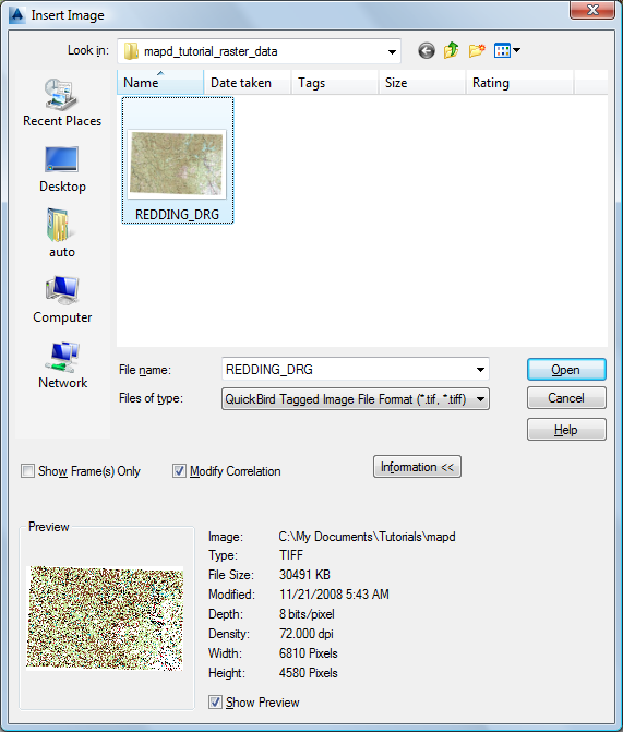

To insert a raster image
. Find
Information displays a preview and image statistics.
The Correlation Source is a World File. The actual file is called REDDING_DRG.tfw. It is stored in the location where you copied your tutorial sample files.
The data in the world file determines the Insertion PointX and Y values under Insertion Values. These values georeference the image, so it is correctly positioned in the drawing.
You can manually adjust the insertion values as needed.
